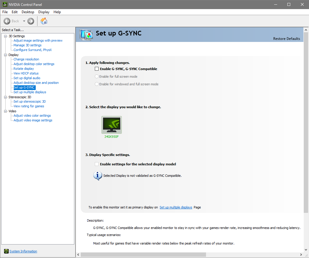

The driver is not providing the full EDID for some reason. The driver only reports a strange virtual monitor with no resolutions, so CRU has no way of getting the full EDID. Try disabling G-SYNC and see if that makes any difference.

(01-19-2019 07:03 PM)ToastyX Wrote:  The driver is not providing the full EDID for some reason. The driver only reports a strange virtual monitor with no resolutions, so CRU has no way of getting the full EDID. Try disabling G-SYNC and see if that makes any difference.
Disabled G-SYNC and did a reset-all, restart. Still showing the same thing in CRU Sad
Logs attached
